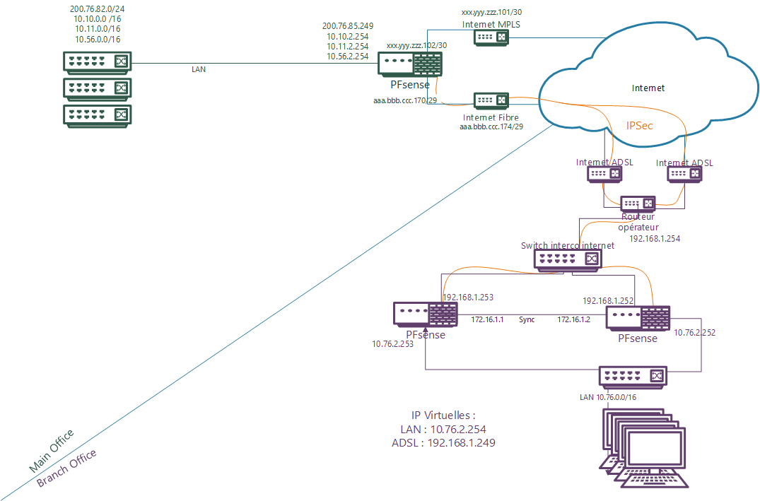

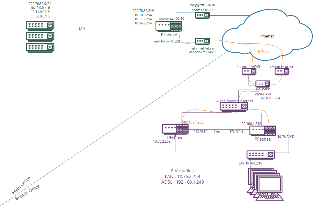

[Edit] Plan has changed for a better, and easier, solution :)
In attach the new scheme.

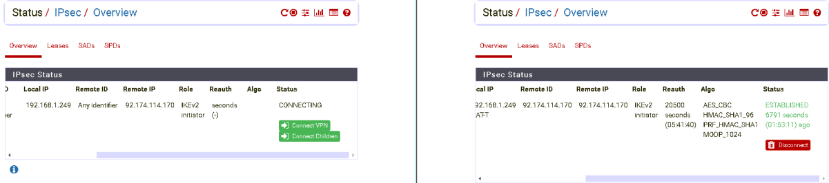

It remain 1 issue : The IPSec on the slave firewall do not connect. I would like to know if it normal, and so connect if the primary firewall crash, or do it need to be also up?
In attach the IPSec status.
