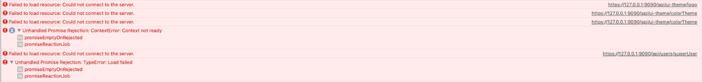

I've configured the CF tunnel to resolve https://localhost:9090 to https://dynfi.myhostname.tld. It loads the login page, but many of the elements on the login page are directed to https://127.0.0.1:9090

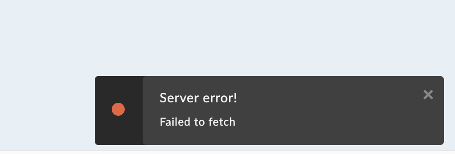

I also see this error when the page loads:

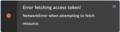

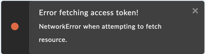

and this error when attempting to login:

What I failed to realize was this
Code: Select all
sub_filter
is rewriting all calls to "/config.js".
Code: Select all
sub_filter 'https://127.0.0.1:9090' 'https://$server_name';
                sub_filter_types "*";
I'm new with 'cloudflared' and their zero trust platform, but I don't think there's anyway to handle that sort of reverse proxy.
All that said, it was easy enough to ensure my "dynfi.domain.tld" was resolving to a loopback address "127.0.1.1".
I ensured that I could
Code: Select all
curl https://dynfi.domain.tld/api/ui-theme/logo
and then setup the cloudflared tunnel origin to https://dynfi.domain.tld instead of https://127.0.0.1:9090.
