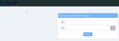

Re: Authentification LDAP
Hello,
Thanks for your response.
The ldap request with ldapsearch are ok with cn or sAMAcconutName, but the log attemps on the authentication portal (attachment) are impossible with the sAMAccountName.
I have tried various settings with ldapUserSearchAttribute and ldapUserNameAttribute (=> sAMAccountName) but without success, only attribute "cn" worlk well on the authentication portal. Even in the user list when we are logged in Dynfi, it's the "cn" that appears.
Sorry but I don't know if I'm clear in my explanation and I can't put confidential information in this post, but I remain available if you need further information.
Thanks for your help.
Regards
Regards
